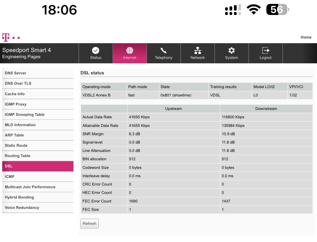

    I managed to get to this page. Not sure how to read this. Is 135mb max i can get in term of speed or?
    Also based on my research even with this i cannot get an actual download available as changing to 250 needs an vdsl profile update and just congstar can check this?
    I tried to look it up and i got that the vdsl profiles are limiting factor based on plan or something.

  • Your Speedport Smart 4 is completely fine for VDSL 250. The line stats look good for VDSL 250. Don't let anyone confuse you: you're currently on Annex B, which is used up to 100 Mbps. With VDSL 250, you'll be using supervectoring and switch to profile 35b.
    Addendum due to some imprecise wording:
    You remain on Annex B. Currently, you have vectoring with profile 17a. With VDSL 250, you have profile 35b (supervectoring).
    Just wanted to share this quick correction.
    Dieser Beitrag wurde bereits 1 mal editiert, zuletzt von Zyrous (11. Oktober 2026 um 23:36)

    I’ve checked the technical specifications of your line, and unfortunately, I have to advise against switching plans.From a purely technical standpoint, your DSL line supports a maximum speed of 130 Mbit/s. This means you wouldn't be able to achieve the full performance :-( Unfortunately, we have no control over the local infrastructure; the property owner would first need to have the line upgraded.

    The 130 Mbps currently being discussed is simply because you are on profile 17a. Profile 35b expands the frequency spectrum, which is what enables VDSL 250 in the first place. This has nothing to do with the drop cable to the building or the internal in-house wiring.
    The only possible explanations would be an error in the database, or that there is no supervectoring line card in your MSAN—which, in 2026, would be genuinely bizarre.
